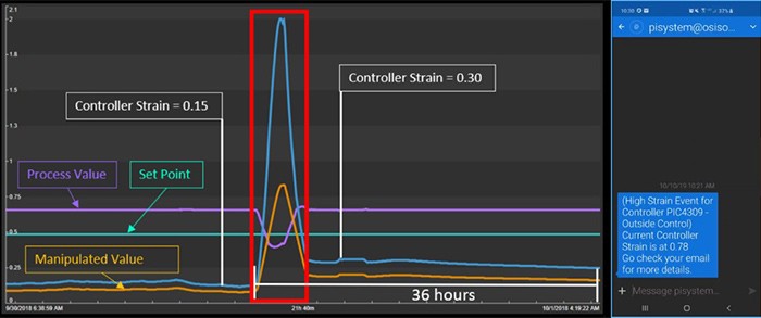

To calculate PID controller strain, divide the manipulating variable (MV) by the resulting process variable (PV). The ratio of MV/PV indicates a controller's strain.
![](/en/perspectives/blog/pid-controllers-ready-to-talk-if-you-re-listening/_jcr_content/root/main_container/main-container/articlepage_containe/column1/responsivegrid/image/.coreimg.jpeg/1713323079761/w009-blog-pid-22-09.jpeg)
Many manufacturing operations today are already storing years of PID controller performance data in their time series historian systems. This historical data is super valuable if you apply analytics like PID controller strain to it and begin to reveal the hidden events that occur in your operation.
