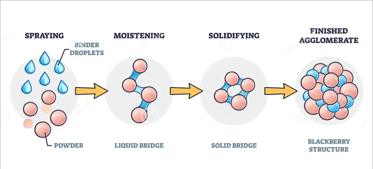

During production, Nesquik and Ovaltine undergo an agglomeration process that involves the wetting and drying of the product until it achieves optimal “fluffiness”—the right moisture and density.

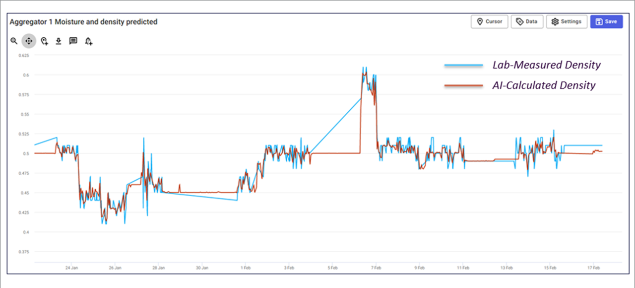

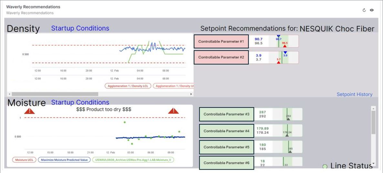

Nestlé’s teams wanted to use real-time production data to predict the powder’s moisture and density levels and generate setpoint recommendations to keep these levels within the desired limits. To do this, they first needed to get their production data in the cloud, where they could perform advanced analytics with AI and machine learning. The team transferred the necessary process data from one of the Waverly factory agglomeration towers into CONNECT data services, via AVEVA™ Historian. Within CONNECT, Nestlé rapidly developed a dashboard for operators to visualize predicted moisture, predicted density, and process setpoint recommendations¾all powered by AVEVA™ Advanced Analytics within CONNECT.
Operators can view customized dashboards, positioned next to SCADA screens, that show predictions and actual levels of density and moisture. Additionally, the solution’s setpoint recommendations panel takes the guesswork out of process control. Operators can simply follow the guidance AVEVA Advanced Analytics provides to ensure product consistency.

The Nestlé lighthouse team trained the no-code analytics models using historical process and lab data, establishing a correlation between the product’s quality parameters (density and moisture) and process variables. These models automatically generate setpoint advice for operators to use in the plant when making equipment adjustments.
