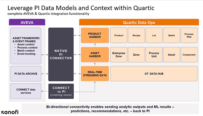

The company integrated AVEVA™ PI System™ and Quartic.ai as part of its reliability-centered maintenance strategy to improve equipment performance, maintenance workflow, and maintenance spend. Sanofi engineers created anomaly-detection models to discover problems earlier, ensuring workers could fix assets before they randomly failed. Sanofi also began periodic reviews of the active work orders and used machine learning to start to identify potential failures connected to different types of work orders. It also introduced physical sensors to help understand and supplement process data by adding vibration or ultrasonics sensors to critical assets and components.
Sanofi used AVEVA PI System to build a standard data and context infrastructure. With more unified data and increased automation in its workflows, planning became easier. The company made productivity gains as its staff were no longer constantly reactively responding to failures. Sanofi also gained an increased understanding of how its assets were performing. Because of the challenges related to working in a regulated environment, Sanofi couldn’t entirely eliminate time-based maintenance, but it managed to reduce the frequency and move towards a reliability-centered strategy.

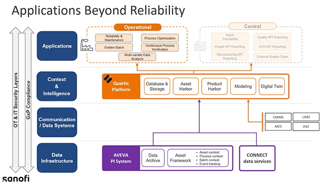

Having successfully integrated its data and deployed anomaly detection models, Sanofi began to scale. It wanted to create more integration with its CMMS system and scale up its analysis with more machine-learning rules. With the benefits of contextualized system and sensor data in AVEVA PI System, Sanofi accelerated its use of advanced analytics.
Built on its anomaly detection engine, Sanofi developed predictive models to gain understanding of risk. Sanofi built a light risk monitoring dashboard to monitor equipment risks and establish an acceptable level of risk—was the current risk small enough to begin the next batch, or would there be a deviation? The dashboard allowed the company to be more proactive and efficient about maintenance planning and activities.
The company then tied online condition monitoring alongside deployed sensors directly into its CMMS system, automatically generating planned work orders for the asset. After full deployment of predictive tech, Sanofi is targeting reducing predictive maintenance cost by 35% by 2025. AVEVA PI System and the predictive models formed the foundation for a global e-maintenance solution, rather than the manual single site processes it had before.

Having successfully integrated their industrial data, predictive models and IoT solutions, Sanofi is aiming for global rollout and a consistent prescriptive maintenance model. The company still has some siloed systems and is hoping to move to a single platform approach. Once its reliability program is ingrained, Sanofi hopes to apply the approach to other processes, such as batch traceability, external supply chain, and KPI reporting.
